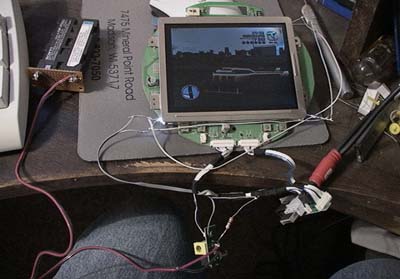

Ah, a personal holy grail of mine. I bought a PS One screen a while ago because, well, let's face it, $130 for a 5-inch TFT screen? You can't beat that!
BUT (there's always a butt) the darn thing consumes around 1 amp (not milliamp, AMP) of power at 7.2 volts. You hook this thing onto a PSOne and it uses as much or MORE power than the game system itself.
So, where to turn... Where indeed! White LED's! Of course, the PSOne screen has this really odd bulb thing going around the backlight plastic. It's U-shaped and covers 3 sides of the plastic. Well, I ditched that thing and stuck in 3 LED's, each pointing down a side, much like marching soldiers or that scene in Tron.
If any of you other tinkerers would like to give this a go, just wire (3) 3mm white LED's in parallel off the PS One's +7.2v power source and put a 22 ohm resistor in front of them.
The end result? A screen that now consumes only 350mA when running, a mere 35% of the original power sucking. GEE! What could I have in mind for this screen? Only time will tell!

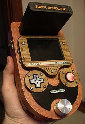

Solid Oak VCSp Built! (Well, there's some plastic in it)
Just when you thought I'd stopped building portable Ataris! Here it is, the first wooden portable game system that I know of. Built on consignment, this unit is truly unique! I call it "VCSp Special Edition"
For more pictures, info and babblings on this device, click here or browse the "Models" tab on your left.
I am considering building (2) more of these oak-encrusted units. Any interested parties should email me their inquiries.

New Super-Awesome VCSp GOLD Under Construction!
And it's going to be FOR SALE!
I was at Best Buy last week, buying all of their pocket TV's as usual, when I saw something. The latest Casio portable, the EV-4500! This sucker has a 4 INCH screen! So, I asked the guy if he could pull it out of the box. I examined the unit and did my usual 'guess the internal layout without taking it apart'. I deduced that it could be adapted fairly easily for a VCSp, and the thing came with free batteries so I was sold!
I then decided that this awesome TV would be used to make VCSp GOLD - the absolute best Atari portable ever made.
New Features will include:
4 inch screen, MUCH larger than the 2.5 inch screen on a Rev 5. In fact, the largest full-color screen on any portable system ever (to the best of my knowledge)
 Joy pad and paddle control on the right-hand side of unit (like the old days)
Cartridges slide in the back, like a Gameboy.
TV / GAME switch. Just like the old systems had, but in this case it allows you to watch TV on the unit. The antenna pops out the top of the unit.
Classic black, aluminum & wood grain coloring.
Headphone jack.
More features & a bigger screen, but still the same size as a Rev 5.
Full-size RCA video out jacks for play on your television, no need for a special cable.
Totally new look with Real Gold Leaf all over the thing.
Pending Features (yet to be completed):
Runs off normal AA batteries with increased efficiency.
