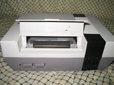

Org NES
How would I go about do this?
I want to make a custom (non portable) case. It would be much easier if I made it a top loader

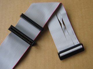

(using floppy cables)long
Spoiler:

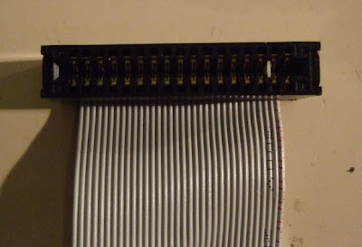

The super-old 5¼" floppy drives has connectors that very-much resemble a smaller version of the NES cart. port, with 34 instead of 72 positions.
Imagehttp://www.nullmodem.com/Floppy.htm
The super old cables were made with card-edge instead of pin connectors.
Imagehttp://marketplace.vintage-computer.com ... _id=106001
These conector can be modified to suit our needs because the pins are the correct distance apart (0.1") to work with the NES.
Imagehttp://squidge.sourceforge.net/mmc/
This is why this type of cable is often used to make NES cart/game connectors.
Imagehttp://benheck.com/nes-micro
It may be necessary to make a bunch of small 'twists' like there was in the floppy cable to flip the top and bottom rows by changing the wiring inside the connector after the original twist.
Imagehttp://www.cosam.org/projects/a1200t/index.html
The wires are retained under a clip that can be removed. Removing the clip without one the first tab does take a bit of practice, however one tab is cut in this modification anyways.
Imagehttp://uanr.com/sdfloppy/

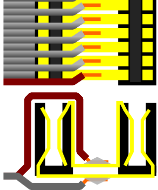

The pins 'connect' to the wires by piercing the insulation and pinching the metal. In nearly all cases the wires alternate between top and bottom row. The sweet feature of this is that either side you put the connector on with the red wire on the left the pinout will be identical!
Except for some three row variants in which the middle row has a rail of forks that connects wires (GND, 5V, shield), however I've only enountered these in the other type of connector, and these always molded in a different colour than the other connectors on the cable.
Code: Select all
1a2b3c4d... }wire order
|a|b|c|d...  }Connector
1 2 3 4 ...  }

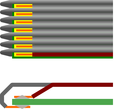

Seperating the wires into pairs then fliping them over would effectively exchange top and bottom (don't split them all the way, otherwise what was the point of opening the connector? :p) Pins can be slid back into the connector if they lift out.
Push the wires into the forks by pressing a dull blade (butter knife, screwdriver, punchdowntool) on either side of the fork and seperate the forks from eachother. Be careful not to pierce the same wire on different forks, this could short them. If it does happen just lift out the wire and try again.
Don't worry about having the ends stick out the other side, this end can be hidden inside the case, or trimmed after it is closed.
Once this is done you will have a lo-o--o-o-ng cat, skinny version of the U shaped NES cart connector.
Use a multimeter or continuity tester to verify that the pins are connected correctly, and are not shorting with their neighbours. Top 1 conects to bottom 1 but not bottom/top {a,b or 2}. etc.
(can someone confirm the wiring order of the U shaped NES cart connector?)

Alternatively; if there is only one floppy cable, it can be cut so that there are two lengths of cable than can be soldered to the NES mainboard, remember to undo the original twist.
cut here
]====]====| -or- ]====|====[
A sharp knife can cutout one side of the connector open and remove the 'key' if it is present. A hacksaw/hacksaw blade will also work, but may damage the pins.

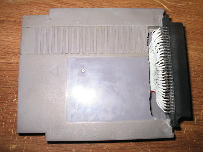

34 + 34 ≠ 72, but the missing four positions are not used by most carts (none that I know of and I don't have a NES!), and are listed by Ben's NES-Famicom Cartridge Chart! (PDF) as being EXP2, EXP3, EXP6, EXP5 which are not here on the Famicom.

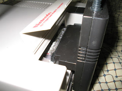

ImageNES SMB3 by Reintji, on Flick
(the original U adaptor)
Spoiler:
Soldering wires to the original connector and the mainboard will allow the games it to be positioned anywhere too, though this would be more difficult to reverse later.
Depending on where you want to put it it may make sense to use ribbon cable and fold the wire over underneath the NES main board. (ribbon is on top in illustration)
there is one slight problem with this plan however:
Image unless all of the wires cross then the label will point to the back.

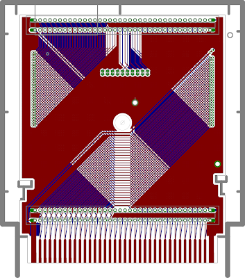

It's unfortunate that card extenders are now digikeyridiculously expensive, if they cost what they did 15 years ago you could just pop one in to your cart slot and have an instant top loader.
hmm...Unless I've gotten GND and CLK/5V confused.
2010.08.26.zip
boardart of possible NES card extender w/ 180° flip. (pdf) 75% probability of it working. 25% possibility of it edning in disaster.
(76.86 KiB) Downloaded 431 times
TomKStones

I would prefer full compatibility. 72 wires from the connector to the mobo seems like the only way.
Umm, what does that picture mean :S
Snow_Cat
Posts: 463
Joined: Fri Aug 13, 2010 12:40 pm
Steam ID: Snow_Cat
Location: Here
Re: Relocate NES game connector?
Post by Snow_Cat »
72 wires it is.
The picture is of a hypothetical 'cartridge' that would plug into an unmodified NES extending it to where the cover is.
It also rotates the port 180° so that the label would face forwards. it is incompatible with the original cover, not terribly cost effective, and only has 62/72 pins because I am lazy, and I don't have a physical cartridge to measure.
Similar to drk421's nesdev.parodius.com72-NES/60-Famicom adaptor, this design moves the cart connection point forwards. (images)
