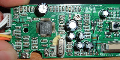

If you are relatively new to modding, I would suggest going for the straightforward Composite linkup, the connections are in this photo:
http://picasaweb.google.com/nubie07/Aud ... 2591676498
Off to the right I have soldered in my own White, Orange and Yellow wires, these are S-Video (one is ground, one color, and one intensity/brightness), if you only use Ground, and the proper connector you can connect it to Composite video easily enough. (Don't remember which, but there are only so many options, I had to fiddle a bit til I found the right ones.)
I was able to score and snap off the Backlight inverter (I had a clearly seperated High Voltage circuit, when held up to a light you could see entirely through the board in the middle, with 2-3 wires going to the Fluorescent backlight high voltage side: http://picasaweb.google.com/nubie07/Aud ... 6329595938 ), I didn't use LED backlight because this is for a DIY projector. An LED just needs enough voltage to light, and not enough to burn up. If you buy an LED it should say what the voltage is, and then you can decide on the power source. Yours seems a bit different, but might be moddable as well. EDIT: It isn't, my second D1500A has your style of power board, and I broke it trying to remove the high voltage side, now it only gives the negative voltage, no 5v+ or positive medium voltage (10-20volts). I would leave it the way it is unless someone knows something I don't. I am now using the power supply from the pictures I have, I will let you know how my LED mod goes.
I also was able to remove the brightness dial from the sound board, I didn't hook the amp back up, but it is also very easy to do. Your board seems the same as mine from what I can see. To get the amp working you just need to reconnect the ground plane, and attach the speaker wires by following the traces to the other side of the brightness control. Bonus is two headphones and a sound control!
PM me if you are still stuck, I have a really nice Macro camera (as you can see), and I can show you where to solder if you are stuck.
