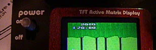

The original power switch is still used, as seen here.
