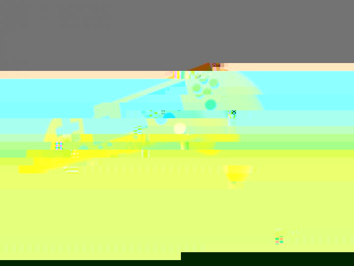

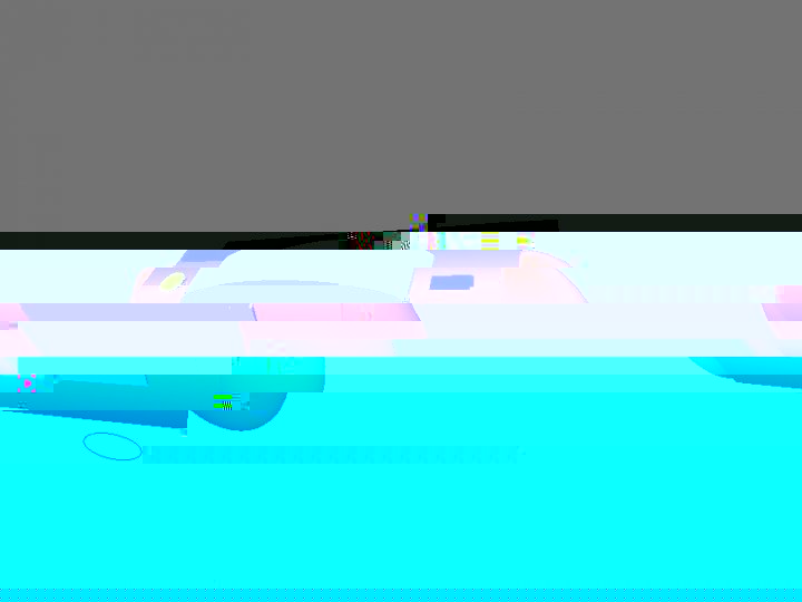

Alright, I believe that I am finally ready to partake in this little adventure, and through it i hope to find a new hobby. I have done different mods in the past, from adding buttons to make controllers a little more easy to use (I have really small hands) to my xbox which can't get much more modded without going liquid cooled or mod chip(no thanks). I have been researching this through the benheck.com forums for quite some time, and i believe i have the sufficiant tools and knowledge for the job. If anyone has any ideas that could be incorporated that they have thought up and just haven't wanted to try them for risk of damaging their stuff, let me know, i don't really mind all that much if i ruin something for the sake of furthering knowledge. Any advice is always welcome as well
Tools:
15w/40w adjustable soldering station
flux
tin
Rosin core solder
copper braid
knives/scissors
dremal
plan on making a vacuum-form platform
parts on their way or in my possession:
TI PTH08080WAZ Step-down Regulator
capacitors
resistors
PSP analog stick
Wire
Parts plan on getting within next week
N64 console
3rd Party Controller
Sony PSX screen
If there is anything that i have forgotten, please let me know. I have the book created that tells about how to make for the nes, snes, and psx.
Some rough designs
Tools:
flux
tin
Rosin core solder
copper braid
knives/scissors
dremal
capacitors
resistors
PSP analog stick
Wire
N64 console
Sony PSX screen
Some rough designs
- Attachments
- 12301_1233600370052_1530473871_30550293_3821042_n.jpg (17.25 KiB) Viewed 10090 times
- 12301_1233600290050_1530473871_30550292_3629064_n.jpg (13.9 KiB) Viewed 10090 times

Thanks. I need to really see about how things would fit so i just made a quick 3d blender rending. It helped me to figure out spacing a little bit more. Hopefully it will look close to the same size, and come Monday, i should be getting my parts so i can start working on it and see how well it will fit into the idea i have in my head

Looks like you have a good grasp of things so far.
As for the portable, you will most likely find the grips on each side are totally unnecessary and just make the portable bigger, heavier, and more awkward to hold.
I would suggest building it without them.

Well, i start working on it in a couple of hours, but i did finish a quick rendering of it. I know its not great, but it will give yall an idea of what it will look like. I forgot to include a build in controller holder for port 1 that will be a 3rd party due to its slimmer design. the screen is a 7" from a dvd player extended screen (for vehicles). luckily, this one actually accepts composite video so it should work just fine.
not actual colors, just something to show the different parts
