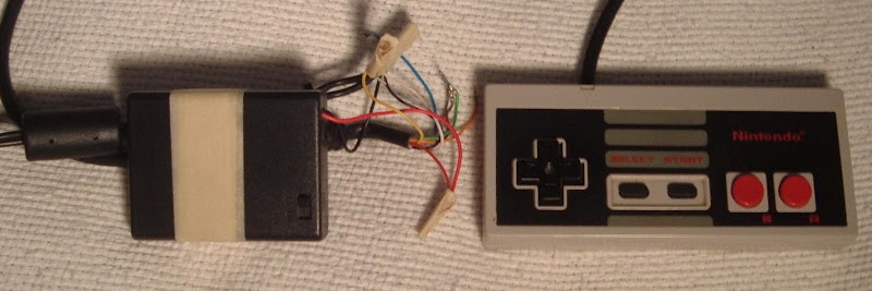

First, yes I know that Joe built one, and his was much better, well mine isn't, but I think it is pretty damn good for $5 :P.
Full size and whole album: http://picasaweb.google.com/lh/photo/qS ... BPKM9u-K4A
I found a Super Joy 3 76000-in-1 (yes, actually yes, and it tries to show you, but if you go to 76000 it is almost a random game, not what the title says :)), I didn't have any $$ so I came back another day and bought it for $5. I tried to play it and the buttons were pure crap, they were very hard to press and then they would "snap" down. Useless. I ripped out the mainboard and wired up a battery pack and the 2nd player as first player, but the Genesis clone controller it came with was just as bad, if not worse.
So, I dug out the NES controller I had, but I had stripped it for a failed PC Joystick project (back before the USB converters were available, and I didn't feel like designing a Joyport version). So I had to cut up the 2nd player controller for the glop-top to get it working.
It just uses a 4xAAA pack with a switch, I use 4x NiMH for 5-volts, no regulator (Who knows what could happen if somebody threw Alkalines in there? :) ).
Full size: http://picasaweb.google.com/lh/photo/gP ... rZRF3HoKPQ
Does anyone know what the deal is with these super joy? They have a second 'ground' (is it a button matrix?) for the alternate A and B, and another button that seems to be A and B together, weird.
I was starting on the project and figured to jam the whole shebang into the controller (except the batteries). I was psyched until I saw the one that Joe built with the backlit Nintendo logo and the Cart connector. I don't feel too bad because I only spent $5 total and don't have any NES stuff, no controllers, no systems, no games, no memories (well, next to none). I have been loving me some Tetris II and still can't figure out the insanely hard Competition Lode Runner that this comes with (hints?)

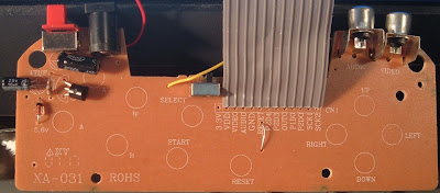

Just some info for newbs (or people who already cut up their boards :) ), I traced the boards in case I had to cut them up for the controller glop-top:
Main controller PCB with Audio/Video, Power switch and 5v regulator:
Full size downloads: http://picasaweb.google.com/lh/photo/cN ... kz-nhFg4uw
Back side, pretty well labeled already :), the zener diode is connecting the controller buttons to ground, I think.
Full size for downloading: http://picasaweb.google.com/lh/photo/qN ... UQLNBJgahQ
