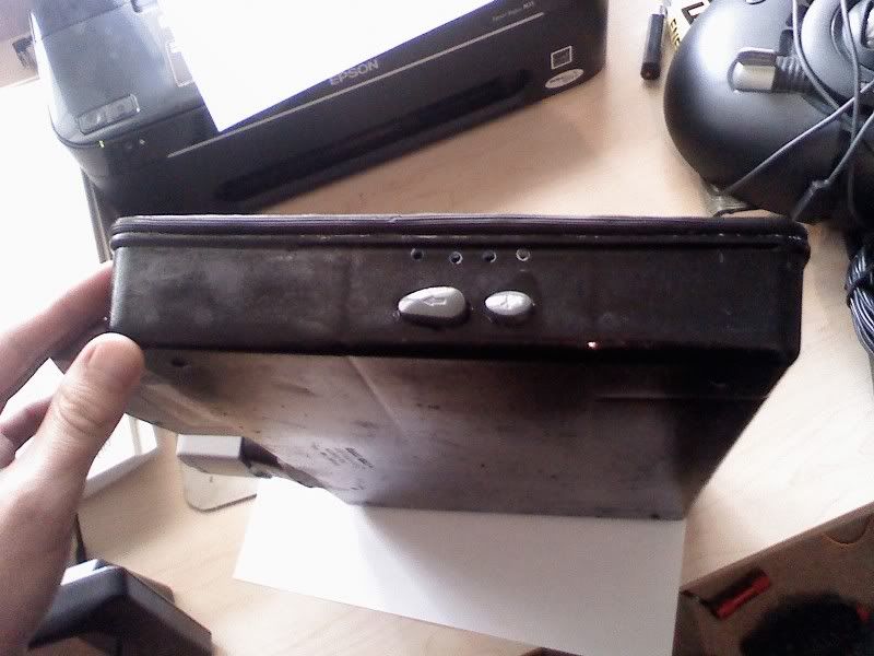

Features

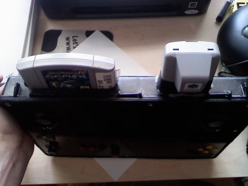

*Cartridge slot at the top of the device
*Full external rumble pack\memory card capability

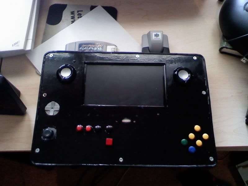

*All N64 buttons functional including D-pad

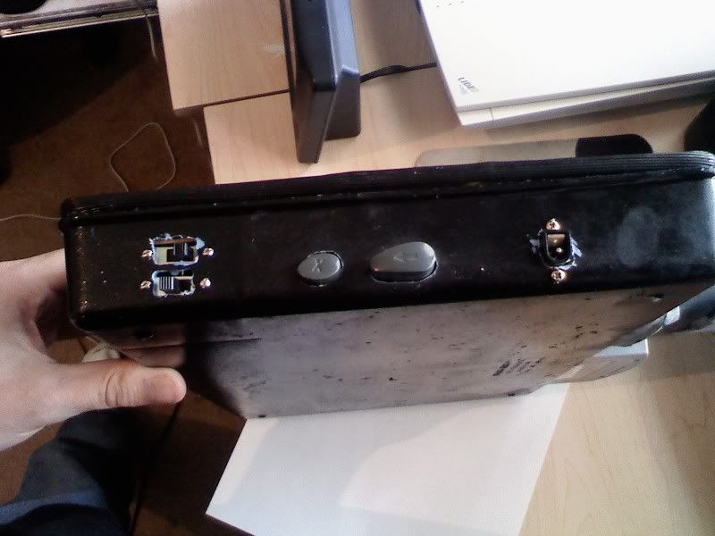

*Aluminum heatsink w\fan over RCP with on\off switch
*RAM expander soldered to board
*On\Off switch
*12v power supply powers both N64 and video via built in external jack
My gripes and things I want to fix
-Needs repainting
-A\B\C buttons are crap radio shack push button switches disguised as N64 buttons(they suck)
-Need to find some way(a duct) to vent hot air from my fan
-Cart slot is not particularly the right size and it wiggles around
-crap LCD screen has bad picture and mono audio output
-Need to find a 12v battery and charger to take this thing off wall power
-Need to hook up a headphone jack and an external N64 controller jack.
-Other than that, it works pretty good.
Before I closed it up I hot glued EVERYTHING. And put automotive bearing grease on the analog stick friction points. Tell me what you think. :D

*Added some bondo to the cartridge slot so it doesn't wiggle anymore
**Added a decent fan and an air vent
***Replaced face buttons with tactical switches that work much better
