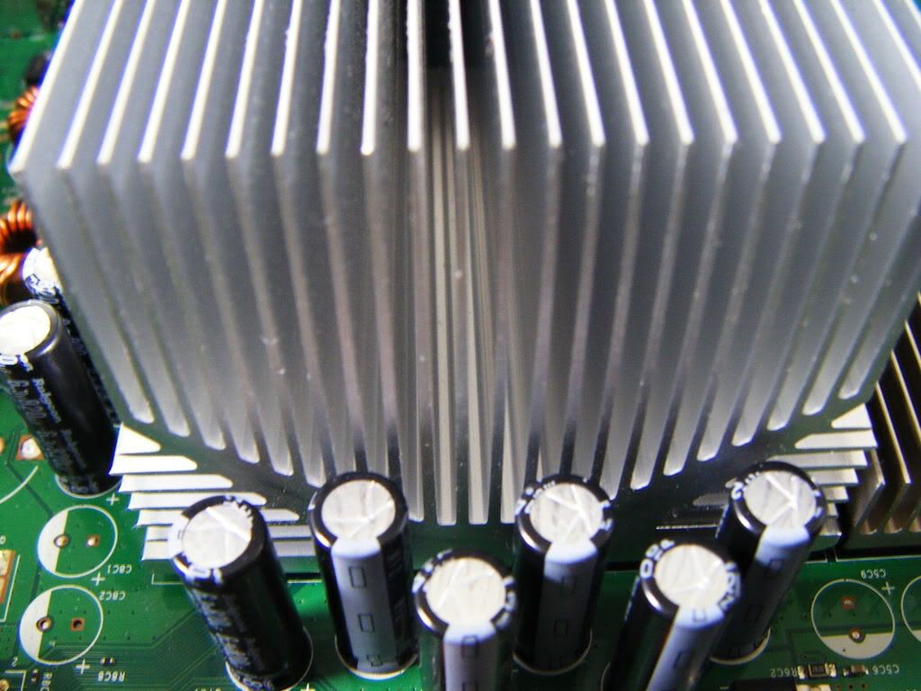

Q.3 Should I just use the old heatSink and crush it? How do I know which one is the old one, and which one is the new one. Doesn't the new one have that extra peice off the side (or is that the GPU heatsink?

I'm not sure "crushing" is the best description of what you want to do with your heatsink. This is the heatsink that you can rework
It has a copper base and thin sheets of stainless steel sticking up off it. It's pretty easy to pull them off with pliers so that you're just left with a copper base. Then you can put extra copper on top of it.
The newer heatsink looks like this
This is the one you can't do anything to. It needs to be half as high as it is and it's not worth cutting. If you have this one, find the old one, or make your own. And yes, the thinner GPU heatsink has the extended portion coming off of it, not the CPU.
