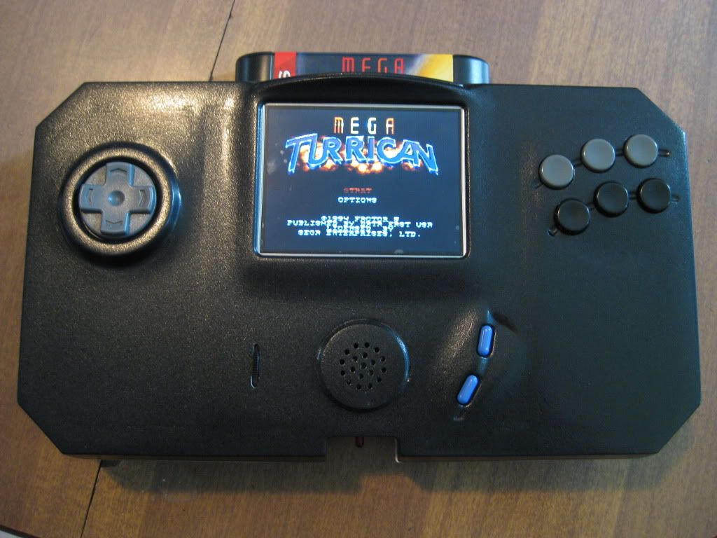

Mega Tiger - A Sega Genesis Portable
Build Log:
http://forums.benheck.com/viewtopic.php?f=12&t=35858" onclick="window.open(this.href);return false;
Specs:
Genesis Model 3 system board
3.5" LCD screen
SuperPad controller
80's Tiger Electronics frankencase
(2) 3.7 V 3200 mAh Li-Po batteries
LM386 audio amp
low battery led
current draw: 420mA
4 hr runtime
YouTube video:
http://www.youtube.com/watch?v=QoE_iR3lLlY" onclick="window.open(this.href);return false;
