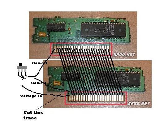

It's easy. Just solder the cartridges' pins together and use a switch to control the voltage on each of them. Here is what I mean:
(It's an SNES cart, but you get what I mean :P )
The wire going to the middle pin of the switch is the voltage in. You cut that trace on the cart so it doesn't receive any voltage. Then, you just wire the switch so that one or the other gets voltage.

Above is bad. The chips wil sitl get the 5v for logic in thats bad when the chip's off. You're better off doing that but with the ce line! (just trust me on this)
edit: I mean it IS REALLY bad. Can fry the chips.
