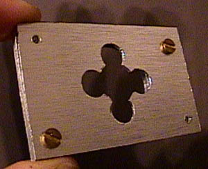

Earlier I mentioned how the Vagabond has to have a new type of control pad in order to work and be thin. Well, my latest experiments have involved just that:
Brass screws and brushed aluminum... yeah!
This is prototype XJ-1 alpha of the Vagabond control pad. The rear of it is a 1/8 inch thick piece of aluminum. The entire front of the Vagabond will be made of such material. It's actually rather light (for what it is) and will render the Vagabond impervious to small arms fire. The 1/8 inch stuff will be painted black, then a plate of nice brushed aluminum (as above) will be on that and surround the controls. This thin plate will hold the buttons down and keep them from falling out! Brass screws will hold it on and be visible for a neat turn-of-the-century look.
But the REAL reason I am using it is because the 1/8 inch thick space can be hollowed out to hold things such as control pads. Therefore, instead of buttons and switches being BEHIND the case (and taking up space) they are actually sandwiched IN the case. This will also apply to the Difficulty switches (which will be in this version, the VCSp didn't have them) the RESET and SELECT switches and the trigger.
