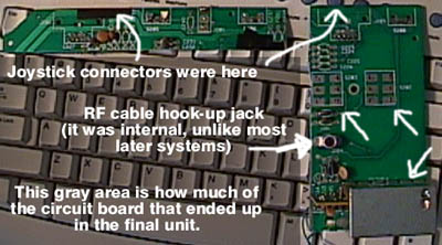

But, who needs an RF modulator in the Year 2000? I sure don't! I removed the portion of the circuit board that used the RF modulator. It cut 2 inches of length off the total. Yeah! Now it was the size of a portable unit. (almost - more to come)

Here are the portions that were sawed off the original board. The silver square things on the right hand side were where the RESET and SELECT switches were. The silver thing in the lower-right hand corner is the RF modulator.
