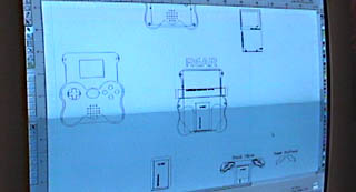

 All the parts, such as the main PCB, screen, controls & battery are measured and reproduced as shape on the computer. These shapes are then arranged as I see fit. Typically, each part is given about .031 inch clearance on all sides. Then, to create the ‘walls’ of the case I add another .1 inch, on average.
The hardest part in the design of any of my systems is the case. First off, you've got parts that are all intended to be used in something else. They can only be sliced up so small before they stop working. Second, you've got to find room for everything. It may not sound like a big deal, but often times moving the battery compartment an eight of an inch can cause the joy pad to move, which then bumps into the post holding the screen, and so on.
Now, the minimum size the case can be is the size of the SNES circuit board. That's a square shape. Now, you can make a system square, Lord knows I've done it enough. But to add functionality and visual appeal, it's often best to INCREASE the size of the unit. You'll notice the SNESp has 'flare-outs' on the sides of the unit below the controls. These do 2 things: They look cool, AND they provide a rest for your palms. Therefore, the weight of the unit pivots at your fingers when you hold it, and the flares rise UP into your palms and stop.
