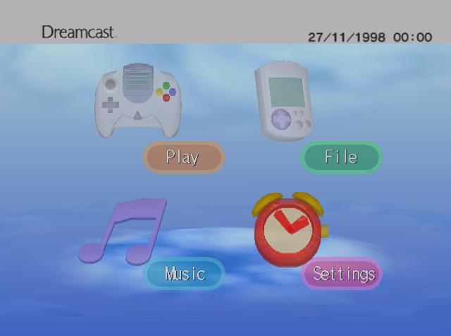

Do you hear a sound from the laser sounding like its going to explode and kill you and your family? Thats good because it means the DC laser is working :lol: (No really it sounds like its gonna die its like weeeeeeeeeeeerrrrrrrrr! wwwwwwwwwaaaaaaaaaaaaaaaaaarrrrrrrrrrrr weeeeeeeeerrrrrrrrr!)
Does the orange light go on when you hit power? if it does, try rubbing the contacts on the A/V wire, and the A/V plug-in place with a q-tip dipped in rubbing alcohol. If that doesn't work and you don't hear the laser sounding like its going to eat you alive then it's probably dead :(
You should get this when you turn it on (or a screen like it asking for date/time)
