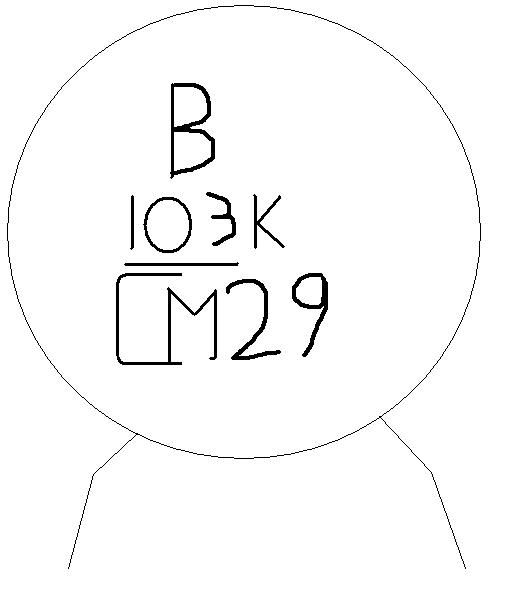

i got mine today and hooked it up and it works :) . only problem is there are some waves that go across the screen. i assume this is because i only used the 100uf cap but no optional 1uf ceramic cap. i looked around in some of my junk for a 1uf ceramic cap but they're confusing because i can't find the uf label on them. here's what it looks like, where on there does it say the capacitance? does it matter if it's a little off or will it work if i use just any ceramic cap?

the capacitace is "103". the way i think this works is the first two numbers are a number, and the last one is a multiplier of picofarads. so. 103 would be 10^3 pF, or 1uF.
the size dosent need to be exact, but a bit bigger would probably be better than a bit smaller (better extra than not enough...)

Kurt_ wrote:the capacitace is "103". the way i think this works is the first two numbers are a number, and the last one is a multiplier of picofarads. so. 103 would be 10^3 pF, or 1uF.
Wouldn't that be .01 uf according tothis? I think it would need to read "105" to be 1 uf.

OK, that's good because the ceramic cap didn't fix it. the thing i got it from also has some 105s, i'll try those :)

see... thats why i was guessing and you werent lazy.
yeah. i also forgot about the nano inbetween pico and micro. lol.
