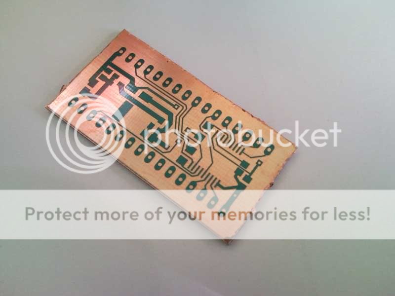

Got around to designing the rumble pak on a 32 pin DIP for experimenting. It'll have just the basic rumble pak components wired just like a 1Mb SRAM chip. It will also contain a tiny vibrating motor so I can see if it's working or not.

Got around to finishing up that rumble circuit, here 'tis:

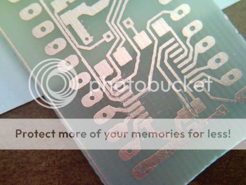

I'm starting to get the feeling that these boards with photo resist I've been using are causing me problems. In some areas, the resist doesn't completely develop and I get copper bridges that I later have to go and scrape off. I never had this problem with MG brand boards but the ones I've been using lately are GC brand boards. Notice how there's also bits of copper scattered in some areas of the board...

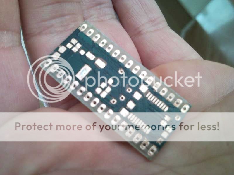

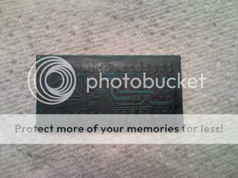

I used some glass paint to make a sort of solder mask. I used an airbrush to spray the stuff on so I'd get a thin layer. You have to bake the stuff after letting it dry for 24hrs. I'm thinking maybe I should have used a lighter color.
Here's after baking it and scrapping off the areas where I need to solder too. Didn't turn out as great as I would have hoped.

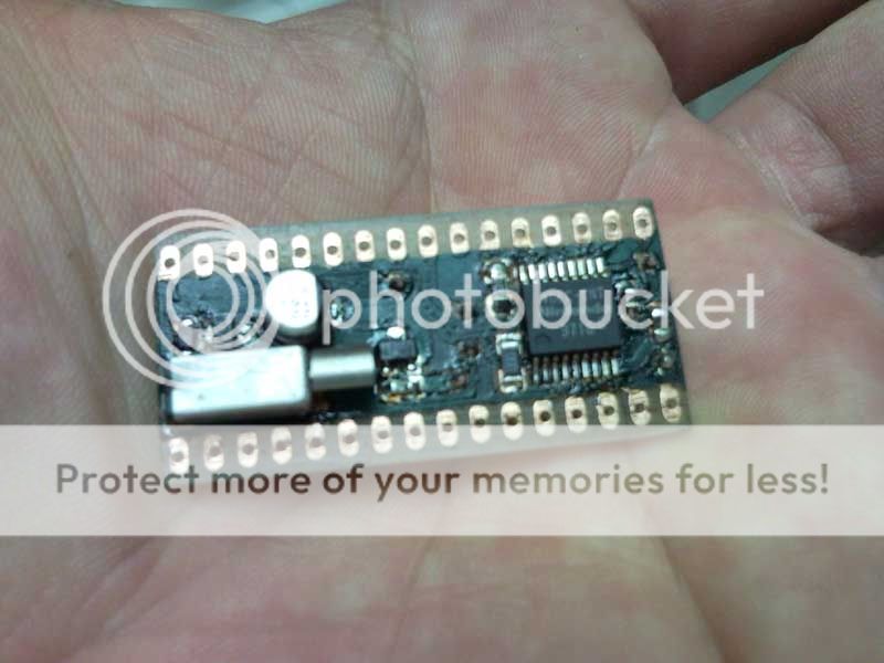

Board populated with components. I thought I had some straight, inline pins but I guess I'm out or I just can't find them. I guess I'll have to go buy some more.

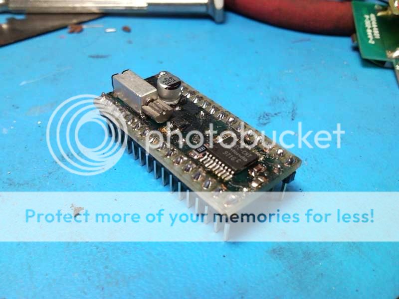

'Tis finished! Now I can mess with it without having wires all over the place.
Yeah, I would say go back to the MG boards.
