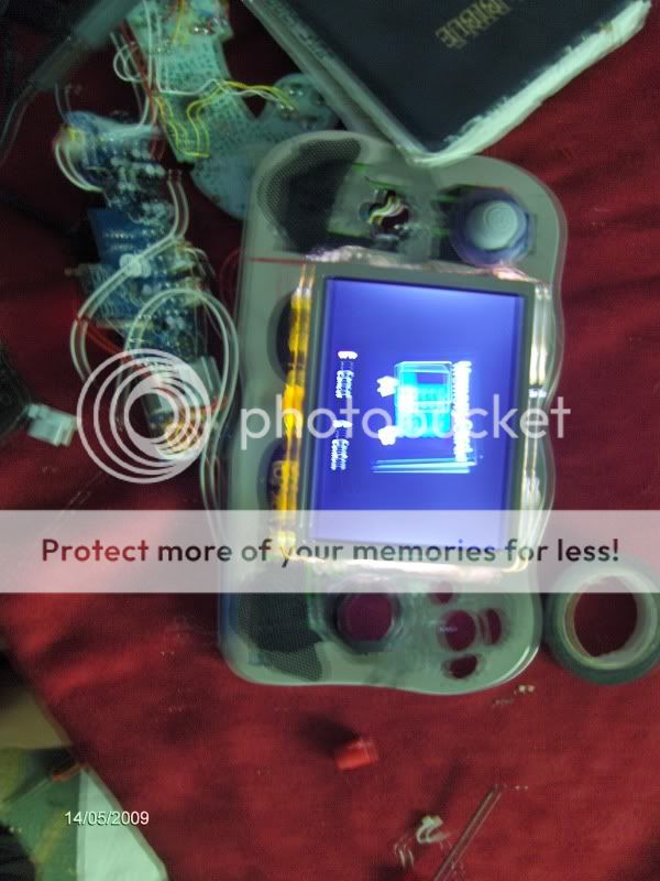

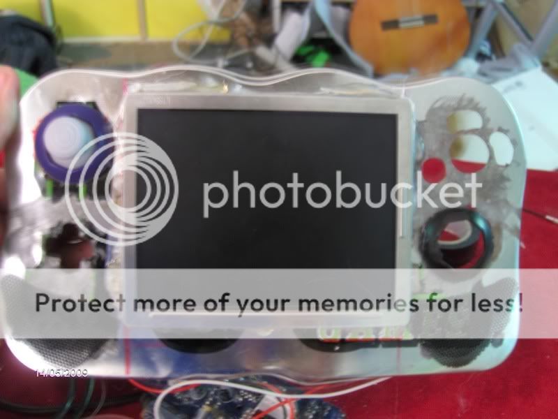

Yay!!!! My first portable almost done!!! I am about 75% done.
Random pics of project!
Well, thats all for now!
I still have to do a bunch of wiring, especially on the controller, but this project is not going to include batteries :(
There are two reasons for that, 1. I can't affort them right now, 2. After wiring everything and put it in the case, there is no room for batteries!
hahahahahaha!!! :?

awesome work mate,its looking good , really good
I like the case :)
hehe, I saw you also attached the led, battery, reset and other stuff directly to the front pins of the cube :)
WTF??? no batteries???
noooooo!!!, please!!!, include batteries!!!, everything named portable should run on batteries :roll:
if you are short of space, consider buy small li-on batteries, and or consider mod the case to get more internal space (thats why my gamecube project case is as big as a entire house ^^), if you still are unable you can consider adding "external" batteries outside the casing, li-on batteries are a bit expensive, btw :
making portable gamecube = toons of work and money xD
