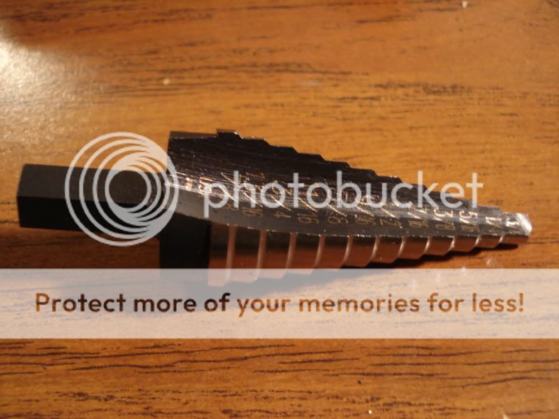

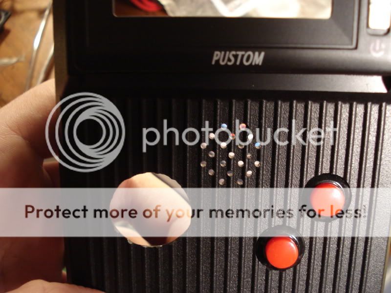

Some perf board as a guide and a steady hand with a drill makes for excellent speaker holes.
If you make cases by hand like I do, I recommend getting an IRWIN Unibit - it drills holes of just about any size in mere seconds. I got a Home Depot gift card for Christmas (WOO!) and so was finally able to afford one - they cost like thirty bucks!
I just won a Flashback 2 for a decent price on eBay so more progress soon. This unit will play both cartridges and the built-in games the Flashback comes with.
I'm going for a real clunky retro look - am I succeeding?
I use those at work. It comes in the big size and a smaller size also. Brings a tear to my eye when I break one and have to buy a new one though. :wtf:

I have several of those step bits, they are amazing. If you have a drill press and a steady hand you can use the next size up to chamfer the edge of the hole you just drilled.

marshallh wrote:I have several of those step bits, they are amazing. If you have a drill press and a steady hand you can use the next size up to chamfer the edge of the hole you just drilled.
If you look closely at the button on the right you'll notice that I drilled a bit too far and did just that - unfortunately that made the button sink down a bit into the case which is not what I wanted. I should have bought one of those bits years ago - they are worth the money for sure.

How does that step bit do on plastic? I've really only ever used them on very thin metal, and I'm just wondering if they're any less prone to cracking plastic than my current method.

Tibia if you are drilling through brittle plastic (Like Atari cases) you can't go wrong with some cheap Forstner bits. Once I moved to these I have never cracked an Atari case.

Rekarp wrote:Tibia if you are drilling through brittle plastic (Like Atari cases) you can't go wrong with some cheap Forstner bits. Once I moved to these I have never cracked an Atari case.
http://www.harborfreight.com/cpi/ctaf/d ... umber=1903" onclick="window.open(this.href);return false;
Do you need a piece of wood or something behind the plastic when you drill (Like you have to do with a spade drill bit) ? Or will it work drilling straight through?
