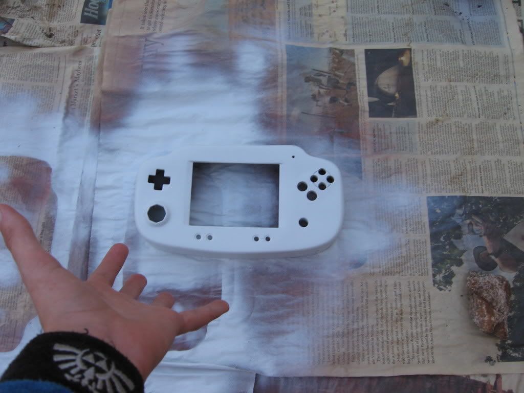

I thought I might show the picture of it being painted...
ZOMG!! its white!!! :D
I'm not finished painting it, I still got to wet sand and such, but it's getting there...

beautiful, it looks like you made a very smooth transition from case to controller pieces.
after you are done I would really suggest some krylon clearcoat it makes the paint much more durable and I really wish I had used it on all of my portables instead of just the mkIII

I couldn't find any at ace hardware, but then again, I was a bit rushed... I'll probably check again soon, like when I finish painting it white...

Yahoo, I got sig'd! :lol: The white looks really nice on this. The layout looks great as well, this > L64. Sorry, marshall!

Bahhhh! (Waluigi Style). I wanted it painted red!

Looking excellent so far, you must be proud of your case.

Looking great so far. The bondo job looks pretty smooth. I'm glad you're putting this much effort into it, it'll pay off!
One thing you can do next time when making the forming template is to draw half the design on paper, lay it over another sheet, and re-trace it. Then you'll have a mirror image. The case looks a good bit off-center.

Yes, not only the centre thickness, but the thickness of the case you would be holding the system - it needs to be the distance ideally between the gap of your thumb and forefinger bases - if it is much thicker than that, it will be hard to hold comfortably, and for any length of time, and to keep your fingers and thumb from moving about. (that is why I ended up with needing 85mm clearance on each side - I could have made it just over 55mm otherwise (to clear the speakers) and made the case I need 6cm less wide; but then the unit would be harder to hold. Trade-off.
marshallh - yes, as you say, it is a little "off centre", however I don't think it is an issue as it is only a bit off and looks symetrical enough - the aspect of "off-centre" which may be less ideal is that the screen hole looks like it isn't completely straight to the top of the case. Anyway, there is always a built-in tolerance when making things by hand and not machined. When playing a game, it may well not be noticeable anyway.

I hate how its off center, but my friends dad was the one who cut it, and he <b>had</b> to use a jig saw over a band saw... the design I did a similar method, where I measured the design, then folded it exactly in half, then cut about a millimeter away because I made it a tiny bit big, but the end result was symmetrical. I also love the bondo job, I've put on at least 20 coats of bondo, and they make a smooth transition between the case and the controller pieces. after a careful measured with said bendy ruler, and it is 2.1 inches thick! pretty thin, if I do say myself...
