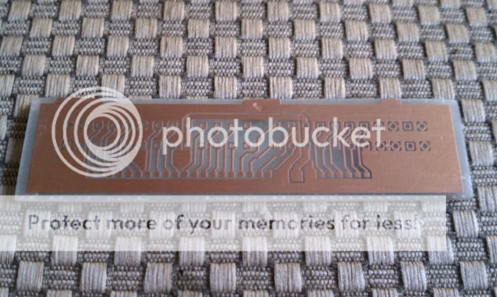

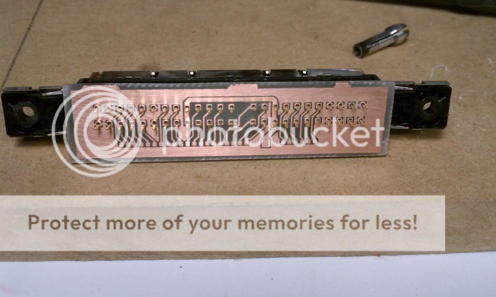

I made a little board that solders to the back of the cart connector and has pads to solder the wires to. It works, sorta, and I have a question for those of you who have done cart relocations before. I'm having this weird issue where only certain games work and sometimes some work and then don't. Mario Kart works 100% of the time, Mario 64 works sometimes and only if I mess with it and make the wires somewhat taut. Tetrisphere I was able to get working once and then didn't work again..... Could it be the fact that I used kynar? I have done continuity checks on all the traces and they all appear to be solid all the way to the RCP. I know the carts aren't bad because I tested them against a known working 64 and they all work just fine. I thought maybe the contacts in the slot were dirty, but I've cleaned them and they're fine. I even took the Tetrisphere cart apart and traced continuity from the contacts inside and they seem fine. I spent about 3 hours last night messing with this and didn't really get anywhere and I'm scratching my head as to why I'm having an issue. Next I'm going to try to solder directly to the RCP. I'm wondering if maybe the traces got somewhat damaged when I removed the bottom connector from the main board.

^^as for first problem i have used kynar to relocate 20+ boards and never had any of those sort of issues, any continuity issues on the actual 64 mobo?
then again issues with kynar are not unheard of
That pcb looks V nice, any chance you could please upload the .brd file or jpeg?
