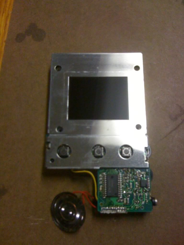

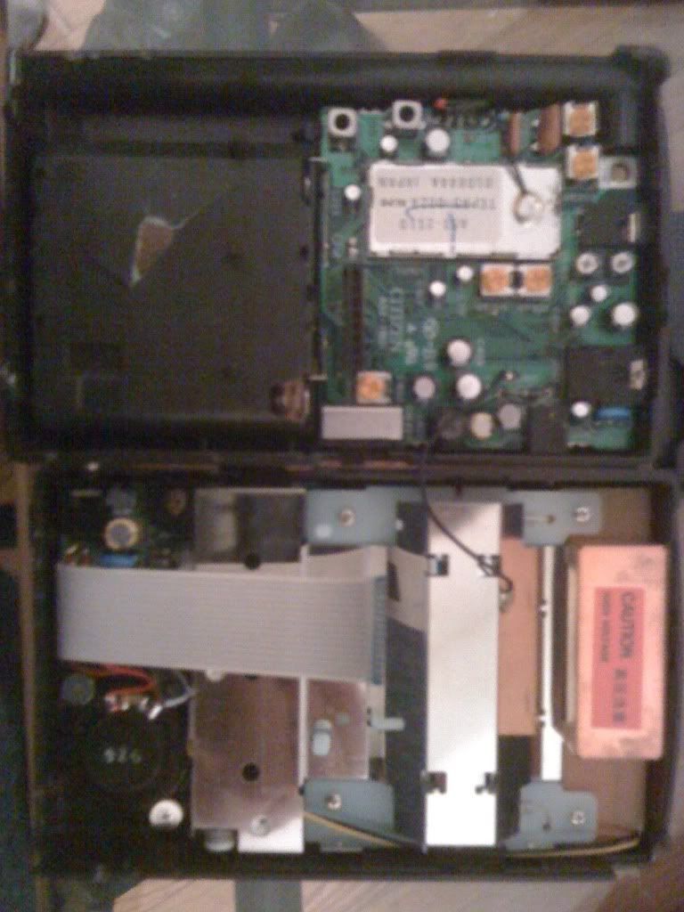

Ok i had Bens book for a while finished reading it a while ago. Im finally deciding to start one of these projects. So i started by bartering off a police scanner i had laying around for an old 2.25 screen pocket tv(yes its small). I took it because it had A/V in. I am probably gonna just create a plexi-glass case because it looks cool. Image So i cracked open the TV. I dont have the nintendo yet im currently working on a couple offers over craigslist. Anyways after opening the tv i noticed the A/V input is on a seprate board as the LCD. The A/V input is on the same board as the tv tuner. Not to sure if i need to use this board or not. Image Image
Let me know what you guys think so far?

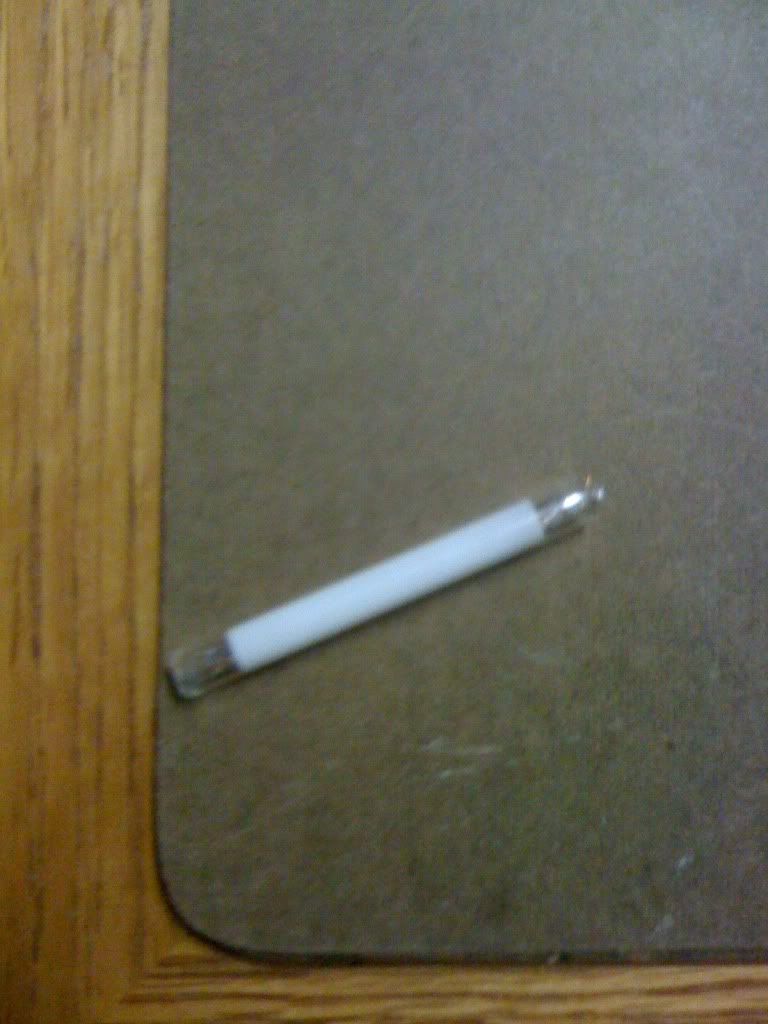

The lcd uses a actual tube light bulb!!! can i replace that with L.E.D.s?
Im also wondering whats behind that high voltage goldish box? Im asuming it has to do with the light bulb?
Yeah you can, There's a lot about it in Ben's book.

After re-reading chapter 4 i felt confident enouph to take out this bulb. Now i need to pick up some LEDs and resistors. Not sure where my 5v spot is yet. I do know where there is a ground thow.
