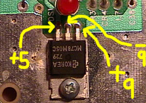

If you want to chop off the portion of board that has the power jack input, don't despair! You can hook power up directly to the regulator.
'Regulators, mount up!"
Here's the 7805 transistor. I have labeled where to hook up the + and - of your battery supply. I labeled it 9, but remember you can put in less. I also labeled the OUT pin of the transistor as +5. That's what gets sent to the Atari circuitry. You could TRY hooking up 5 volts to that spot and the other end to ground (bypassing the transistor altogether) but I'm not sure what would happen. Oh, you'll also notice that this transistor thing gets HOT. Don't worry, it's supposed to. Cook an egg or something.
